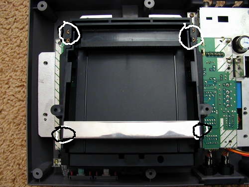

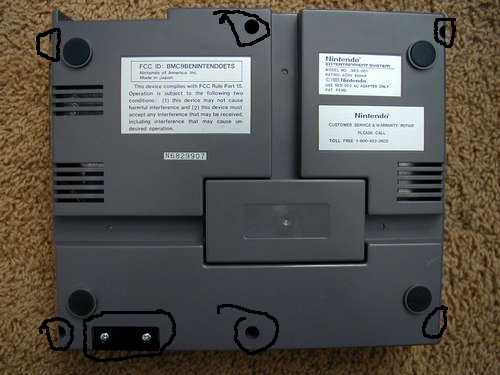

flip the NES over and remove the 6 screws on the bottom and the 2 for the controller ports

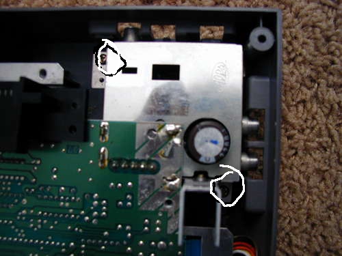

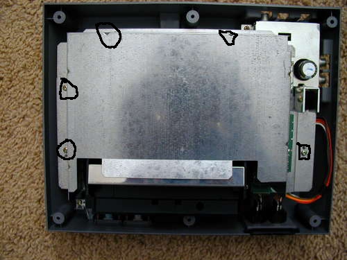

flip it back over, remove the top, and take out the 5 screws holding the shielding in
take the shielding off, and unscrew the 6 screws holding the cartridge mechanism in
remove the cartridge mechanism (you may have to slide it forward a bit) and take out the 2 screws near the RF box in the upper right corner
unplug the two player ports and the power/reset plug
pull out the NES board

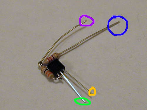

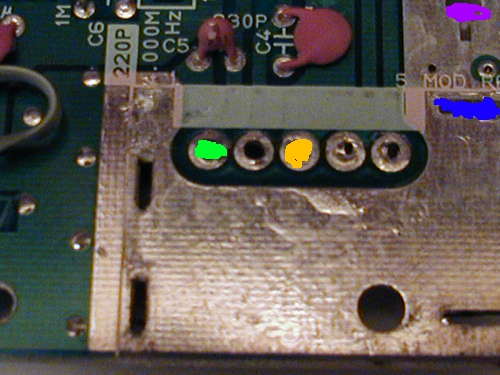

add the video amp:

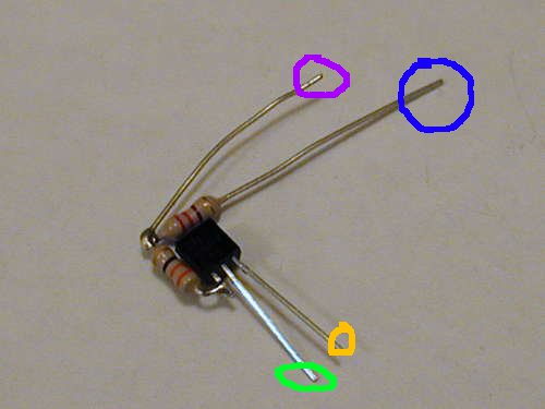

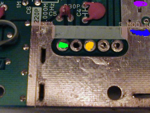

2N4401 amplifying transistor
33ohm resistor (orange-orange-black-gold)
220ohm Resistor (red-red-brown-gold)
soldering iron
the rf box did more than just turn the composite to rf.it also amplified the video signal.when we took it off, the video signal became weak.we need to build a small video amp to boost the signal
soldering the amp together:
solder one end of the 33ohm resistor to the base of the transistor
solder the 220ohm resistor to the other end of the 33ohm resistor
that point is your video out
we will connect that to the screen later

a/v on the nes
once you are sure the screen works fine
solder the audio and video wires to the appropriate spots on your NES board
the audio wire just gets soldered straight to the pad on the NES board
but the video wire has to be attached to the amplifier we built
solder it to the video out wire on the amp
see the picture if you need help
