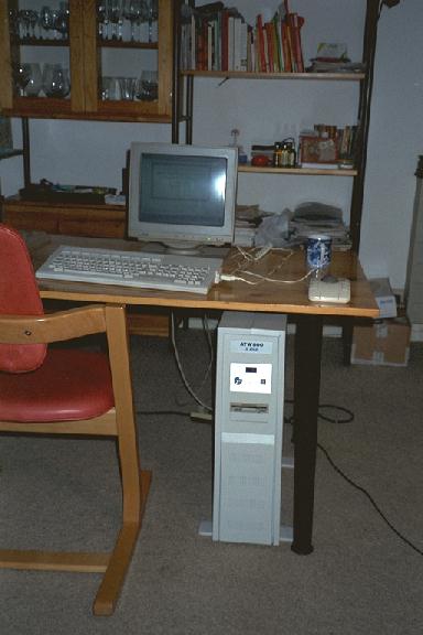

The ATW800 comes in a rather imposing under-the-desk maxi-tower casing (see below for photos). The basic configuration consists of
aformentioned case and power supply (how many Watts? Dunno, off-hand)
the "I/O server", a modified MegaST board featuring the "Morpheus" SCSI interface;
the main transputer motherboard, with a 20 MHz T800 and 4 MB of RAM;
a video/X11 card, based around the "Blossom" chip, capable of
1280x960x16 colours out of 4096
1024x768x256 colours out of 16.7 million
640x480x256 colours out of 16.7 million, two screens
512x480x16.7 million
all at a refresh rate of 60 Hz non-interlaced
expansion slots for
up to four transputer farmcards, each holding either one T800 with 4 MB of RAM or four T800s with 1 MB each
a crossbar switch to allow software-selectable configuration of the T800s
a SCSI interface which can be directly accessed by a transputer, bypassing the MegaST "I/O server".
Thus a fully-equipped ATW800 could contain 13 transputers (260 megaflops) and 16 MB of RAM.
