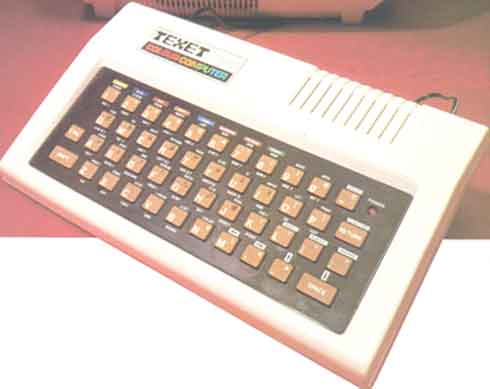

Postby crustyasp46 » Sun Jul 20, 2014 2:04 am
Released in April 1983 and costing £98, the TX-8000 was, for a short while, the cheapest colour computer available. Unfortunately, aside from its price it didn't have all that much else in its favour.

Of the three colour computers under £125 - the Spectrum, Oric and TX-8000 - the TX-8000 is the largest. It case is made of a cream plastic, which feels more brittle than the plastic used for its rivals - but it would still require an act of malice to break it. The design of the case is not as polished as that of its rivals, but it does have a gently sloping front which means the keys actually face the user.
The dimensions of the case are l2in. wide by 6in. deep, 2in. high at the rear and 1in. high at the front. The panel containing the keys is dark brown and sunken into the body. There are 45 keys in a rubber keyboard which is very similar to that of the Spectrum. Not only do the keys squash down in the same way they even have that distinctive clammy feel to them. If anything the Texet keyboard feels worse than the Spectrum's.
Individual keys are smaller than on the Spectrum, but there are more of them. Keyboard layout is based on the usual QWERTY typewriter formation, which the TX-8000 mimics better than the Spectrum. This necessitates fewer key depressions, especially in the case of punctuation symbols which can only be achieved by a shifted key on the Spectrum but have their usual typewriter keys on the TX-8000.
Above the first eight number keys there are the corresponding colour names; yellow, blue, red, buff, cyan, magenta, orange and green. This is the same colour set as on the Spectrum but with the addition of buff and orange. Interestingly, there is no black or white, which look in theory to be unobtainable.
When using the keyboard the letter pressed is what appears on the screen, even though certain Basic keywords are printed above and below the keys. The keywords are accessed by the kind of finger gymnastics that put me off the Spectrum when it first appeared.
Alongside the keyboard is a power light which tells you when the machine is on, which sometimes is not apparent from looking at the screen.
On the right-hand side of the machine is a rocker-style switch, to turn the power on and off. This is a welcome feature, as anyone using a Spectrum or ZX-81 will know that the continual insertion and removal of the power supply plug eventually works it loose. So a cold reset - that is a reset of the computer which clears the RAM - is a simple operation.
